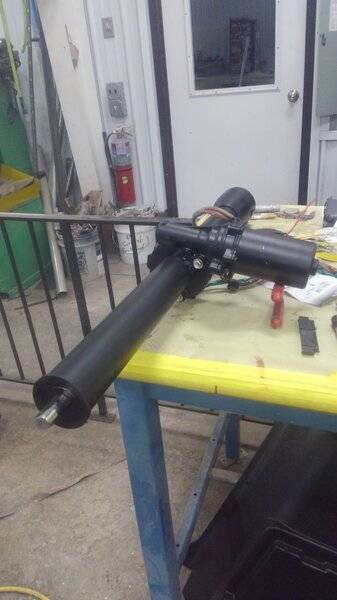

I have put several units in cars and they work great. I use units out of a Prius and you can do it for under 100 bucks.

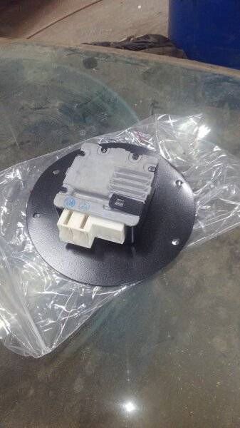

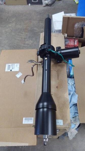

The first pic is a non tilt column,the second is a tilt column. I take the driver's side fresh air vent out and mount the ecu there.(although you can mount it anywhere you want) Hook up 3 wires and your done.
Prius unit works in failsafe mode so you get good road feel but yet easy to turn. Return to center is lost some on these units so I add extra caster into the alignments.
