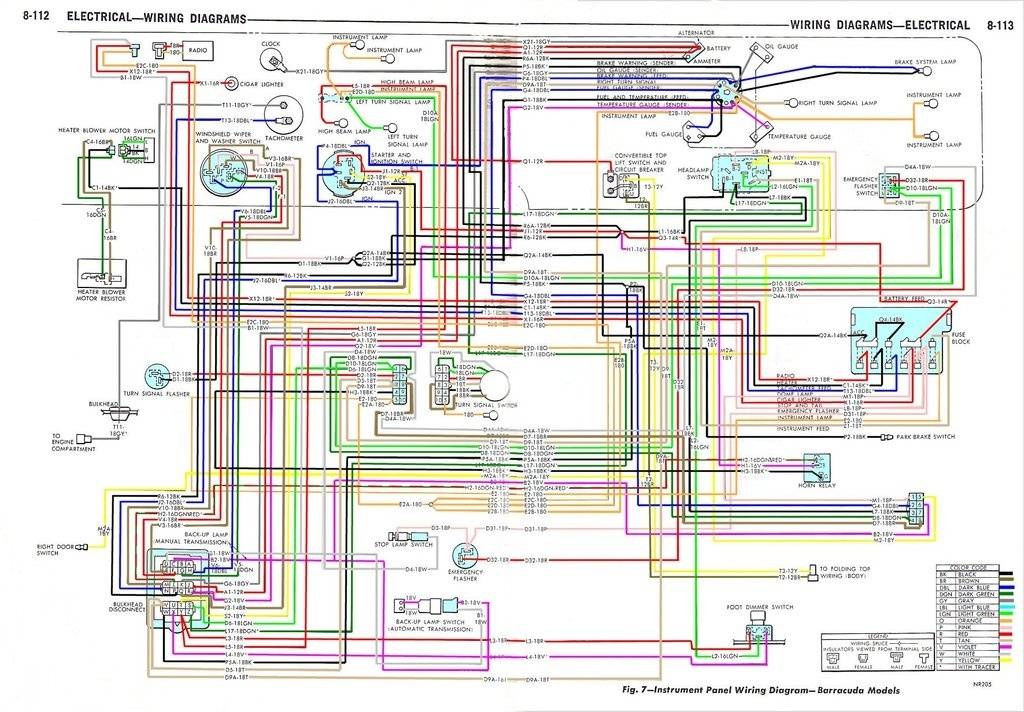

Refresh my memory what's the year/model? Here is a diagram from a Cuda, I wouldn't think there would be a whole lot of difference but it may be able to help you.
