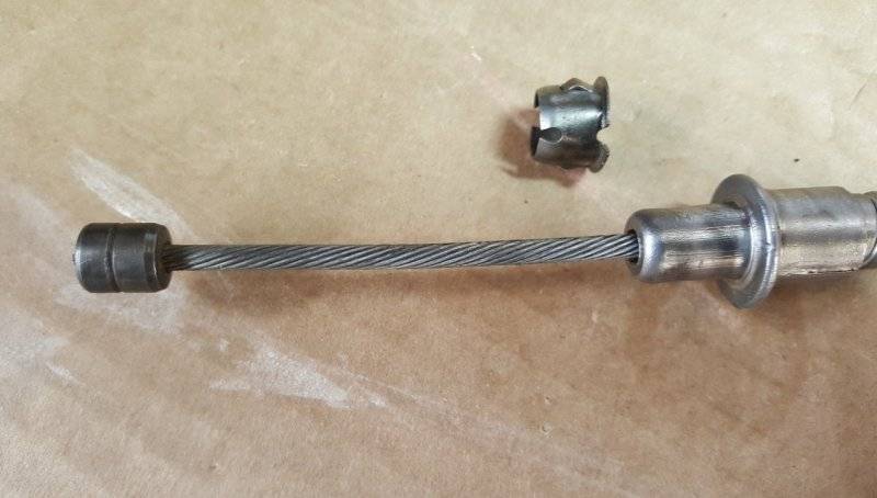

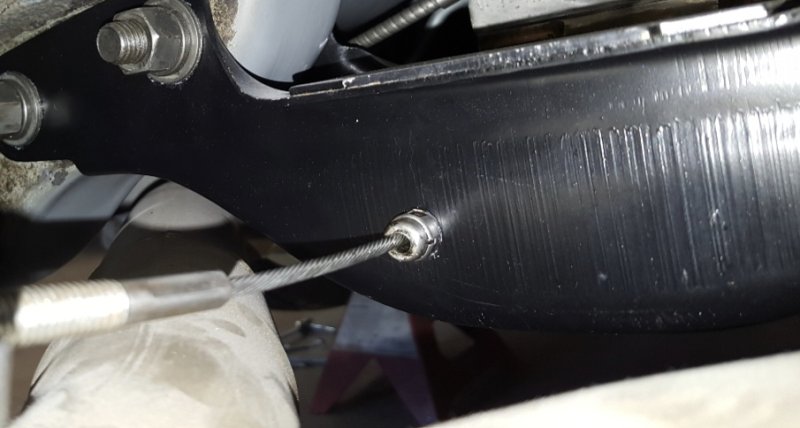

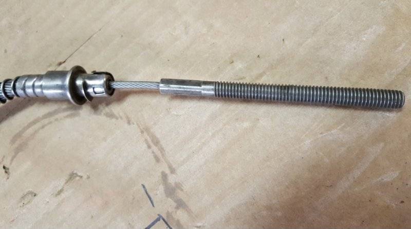

There is a small clip on the rear facing side.
I lost mine.Used a fuel line clamp (Red)

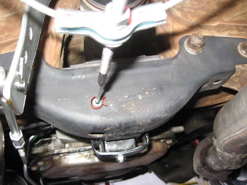

It's a spring clip similar to the one used on the e-brake at the backing plate. Give it a pull.

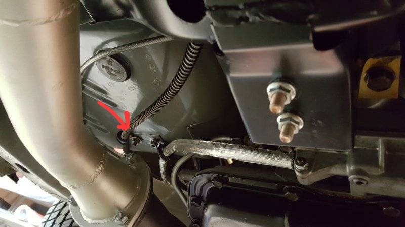

Backing plate end...
The clamp under the floor should be enough to hold it into the cross member.
