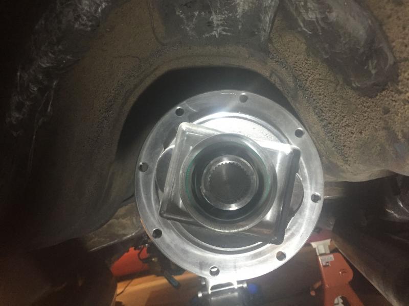

I am continuing to struggle with an engine which is slightly out of linear alignment with the car. It is rotated to the left, or counterclockwise from the top, in the engine bay such that the tailshaft housing of the transmission is toward the right side of the trans tunnel. I am running a Gear Vendor with a wide flange which connects where the factory tailshaft housing would be - just behind the torsion bar crossmember / transmission mount. The flange rattles against the body at idle when the engine is rumbling and rocking - the big cam rumble.
I've done a bunch of shoving and adjusting so it is not nearly as bad as it was when this photo was taken, during the initial installation, but it's still misaligned a bit.

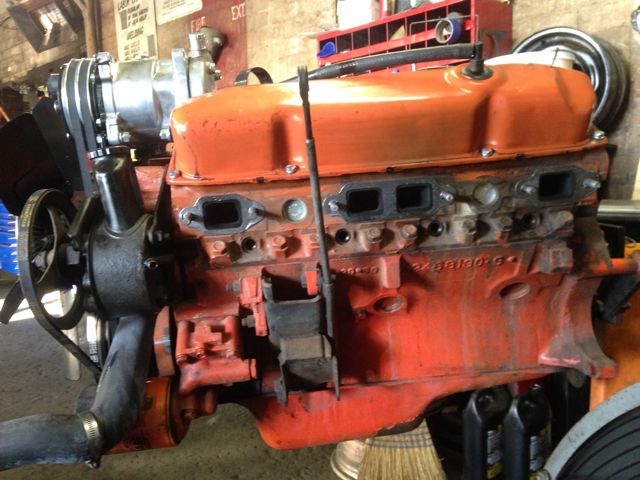

I am using Dynamount engine mounts and was thinking of switching companies to one from Schumacher or someone else, but in looking carefully, it is clear the the mount I have may allow me to "shim" the left side of the engine forward. The photo below shows the left side of the engine (sorry if this is obvious - power steering, oil dipstick, etc.). The front of the car is to the left.
The Dynamount has the same attachment points as the stock mounts in that it rests "behind" the ears on the engine, with through bolts running through the mount and the ear. Because the mount is behind the engine, if I were to put a washer between the mount and the ear at each of the three engine ears, the left side of the engine would move forward by the thickness of the washer. That 1/32 of an inch might result in a couple of degrees of rotation - fan to the right, tailshaft to the left. Five feet back at the tailshaft that might make a big difference.
I checked and I have enough clearance between the fan and radiator to make it work.

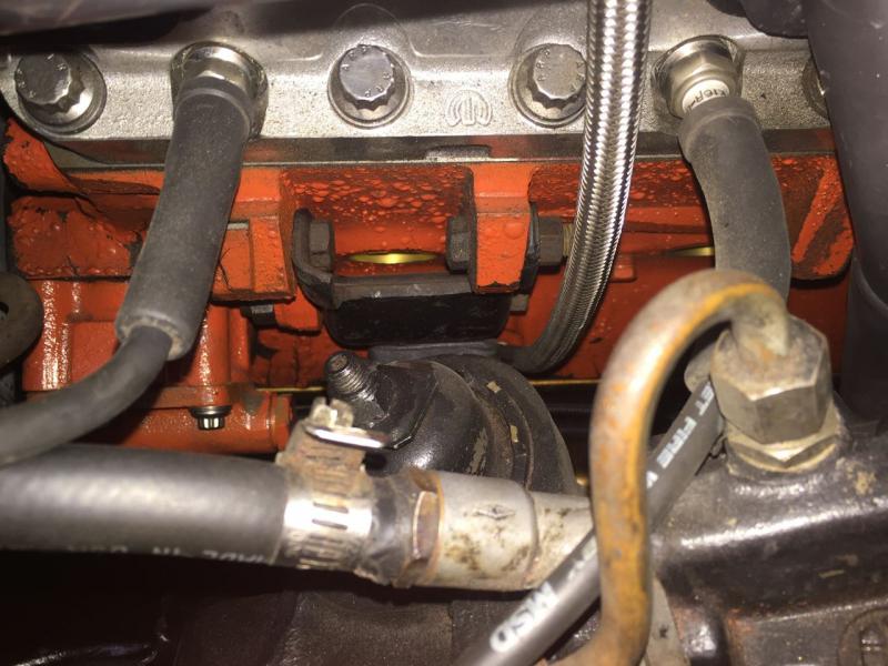

Here's the stock mount as it sat on the factory 383:
It is behind the ears on the block, just as in the picture above.
One of those mounts is off kilter! Spacing with washers are a pita but could work. One of your mounts is too far forward or too far back so one is made wrong.:pimp:
