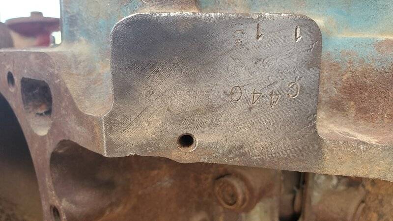

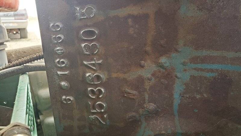

Hi, I'm looking for a little help. I have a 25364305 440 block Dated 6-16-66, Id like some help decoding the engine tab.

Really, the same 'block' HP or Non-HP. The HP stamp means it was built with HP Cam, Compression Ratio, 4-bbl intake, and HP exhaust manifolds. I think there may be a difference in cast vs. forged cranks, and connecting rod type depending on the production year(s), and Induction type when talking early 6-pack engines.

Thanks for the help. looks like its standard and will clean at .030 Ill will be selling it. trying to figure out a fair asking price.
People that are doing accurate type restorations on B bodies will care about the HP stamp, but no one else will. The assembly date would have to be correct for a restoration also.

100% correct, except I don't think there were any cast cranks in 67 440's.
I was speaking in general, not specific to 1966 / 1967.
Here's your HP stamp.
https://www.mcmaster.com/1558T41/
Utterly indistinguishable, and they were the same casting in the first place, same stamp, applied 50 years later. If you're paying more than the cost of the letter stamps more for the block you're being taken.
