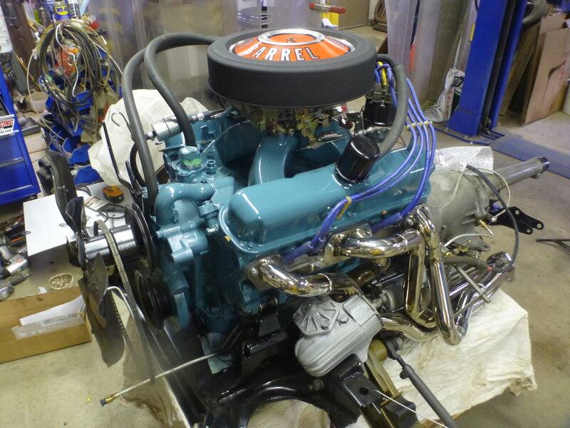

Below is what I have come up with as a good start to find the correct engine color for Mopar engines from 1960 to 1973. After about 1969 they were all pretty much Blue except for a few odd balls. I have seen Slant sixes in Black in the early 60's sales brochures but those are not the best source. I have used information from the Plymouth Owner's club, Walter P. Chrysler Club and various web sites to assemble this list. Engine colors were and still are subject of much debate. It seems no one at the factory really cared about any kind of specification for paint - as long as it got painted - it was ok. These are what I have found to be considered normal or standard - if there is such a thing. Your comments are welcome - however be prepared to back up your arguments with facts from somewhere. I would hope this will be a help to those who are trying to restore their classic Mopar to as near original as possible.
The paint numbers are from Mopar Performance and may or may not be available from your local dealer.

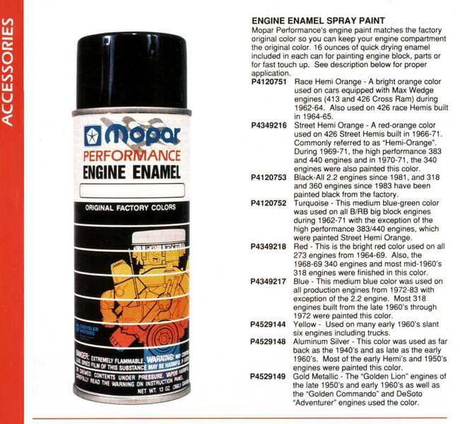

Below is the only factory information I have found on colors
used by Mopar on engines - this is from the 1990 Factory
Performance Parts Book - page 206.

1962-1971, all "B" block engines corporate turquoise with black accessories - some with single 4bbl 426 V8's, chrome valve covers and air cleaners.
