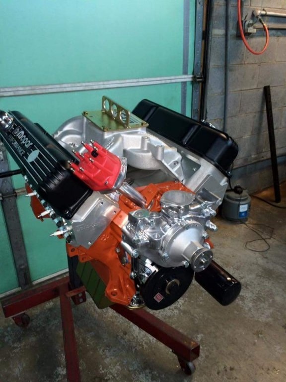

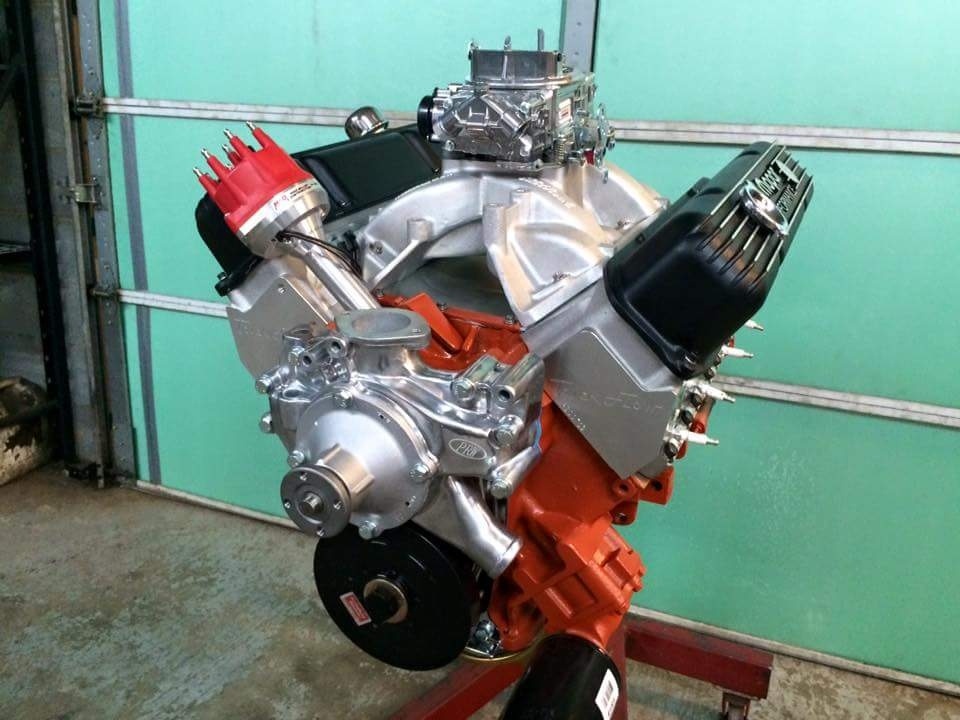

Picked up my motor this past weekend from HP engines up in NC this past weekend. They built me a 400/470 stroker motor with trick flow heads, Eddy dual rpm intake, and a solid 250/250 cam.
Now I just have to remove the 383 and put the motor in. Now I'm wondering if my drive line will hold up to this motor. It's going in a manual 4 speed with an 8 3/4 rear end.
Anyone have any suggestions on clutches, fly wheels, drive shafts...etc...?

yup get it on a dyno !! Great looking motor ! then do the trans
I think you are overthinking things. You know what shape the drivetrain is in. If everythings decent,drop it in and enjoy.
Dana 60. There's a reason they were installed in all 440s and Hemis with 4 speeds. Sell your 8.75 before you tear it up and get a Dana.

Nice ! Let us know How much power it makes I have a 400 block and trickflow heads / intake think I will go 512 CI with mine when I get the money together for the rest of my build just got a Dana installed my car is 4 speed also you will enjoy the car more now !
Traction will cause problems....otherwise, I'd say just keep buying tires.
Center force dual friction clutch and run it. My 12.50 Challenger is still running the stock 100K 3.55 and A 833 423 spline 4 speed. No broken parts. Over 100 strip lasses on slicks, 10k HARD street miles.
