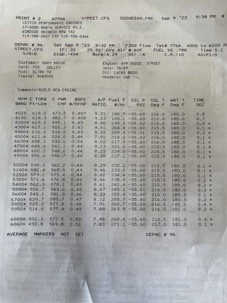

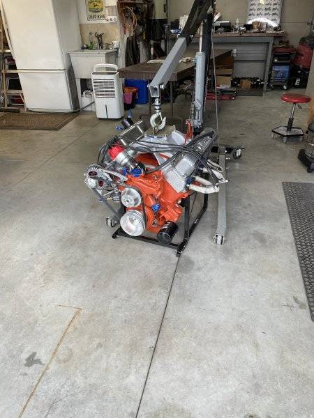

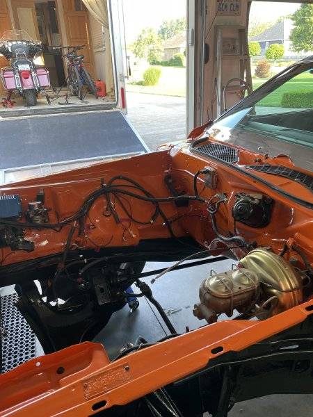

After 9 months I just received my engine back, it has been a long process. Body and paint done. Here is the dyno sheet
Very nice, that will be a blast in a street car. Did they experiment with a 850 carb on the dyno? What cam are you using?
Yes we did. we figured the 750 would be better on the street. We left 15tq and hp on the table. We used a comp cam 23-703-9 with 1.6 roller rockers
Awesome. That's a joyous day!
Hopefully you've been saving for tires.

Consider a small Venturi 950. It’s like a 750 down low, but an 850 up top.
Your numbers look great, IMO
Very close to my 500 stroker. You will love that torque curve. I used a 750 as well.
