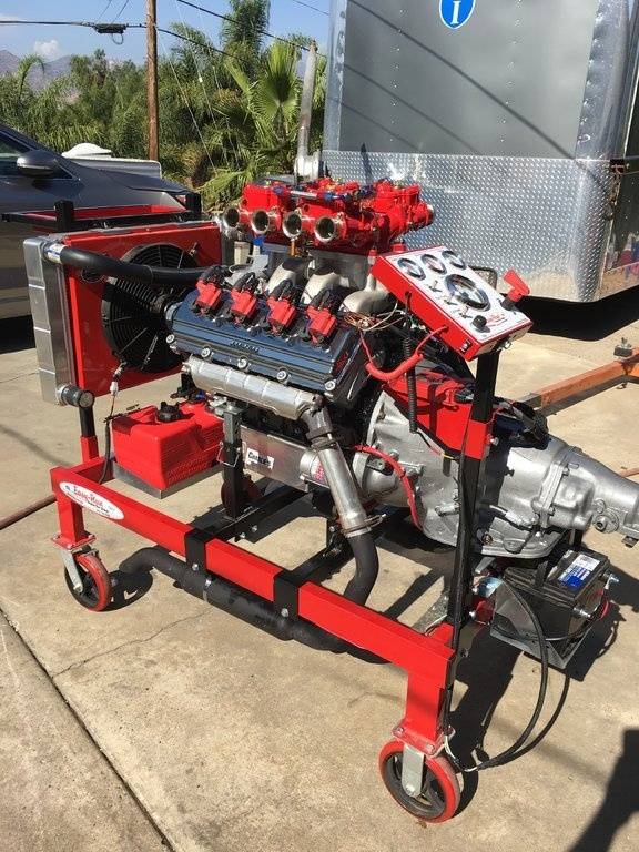

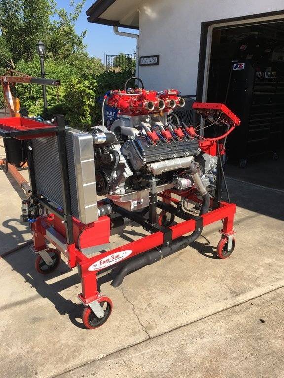

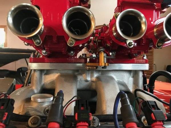

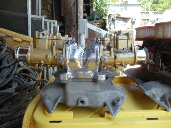

been working on this baby for a while, now I'm looking for a 32-34 Plymouth or Dodge coupe to transplant her in.

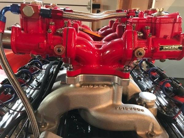

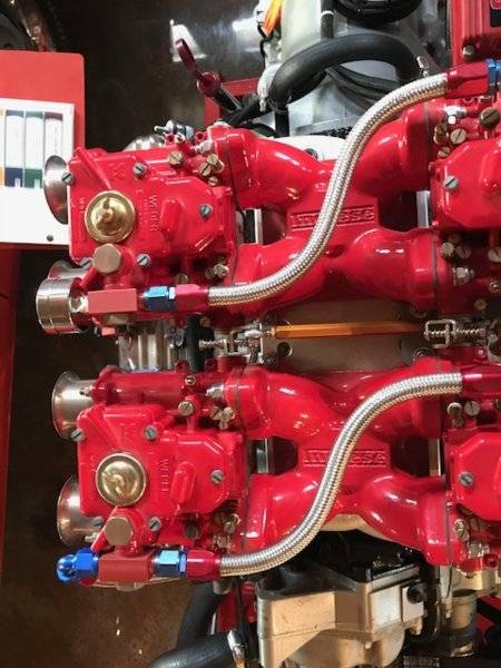

5.7L Crate Engine, Mopar 2x4 intake, 4 sets of Dual side draft Ingeles/Weber Carbs
Mancini Racing linkage, Truck HEMI front timing cover, 8 MSD High Performance Coils, Engine adapter plate to small block A/T transmission, Oil galley kit for use on non-computer cars, MSD HEMI-6 programable engine controller
My plan is either a 32-34 coupe or a A100 wheel stander tribute haven't decided yet
I`d go w/ the coupe if at all possible !
I agree, the coupe is the way to go.
I used a solid plate to reduce any chances of vibration
