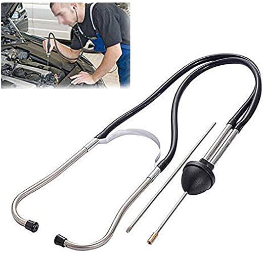

Take a cut off broomstick about three feet long and start her up, listening around the motor with it.... you have to lay the one end right against your head, and see which direction it takes you.... it'll be slapping pretty loud in the bellhousing are if its flexplate related.
