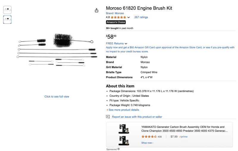

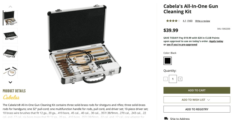

Someone mentioned cleaning brushes earlier, you should invest in some long brushes designed to clean oil passages. These can be bought individually or in sets. I used the brushes from a gun cleaning kit, they work well. Run the brushes through any oil passages you see in both the crank and the block to remove any sludge or debris. Again, do this before machining to remove any nasty stuff.
I like the gun cleaning kit brushes, the length is easily changed, and the bristles are brass and not steel.
Re-clean the oil passages thoroughly after any machine work to remove any metal shavings or abrasive grit that got in there from the machining process.
Here's a couple of kits. If you know what sizes you need, you can buy individual brushes and save some money.

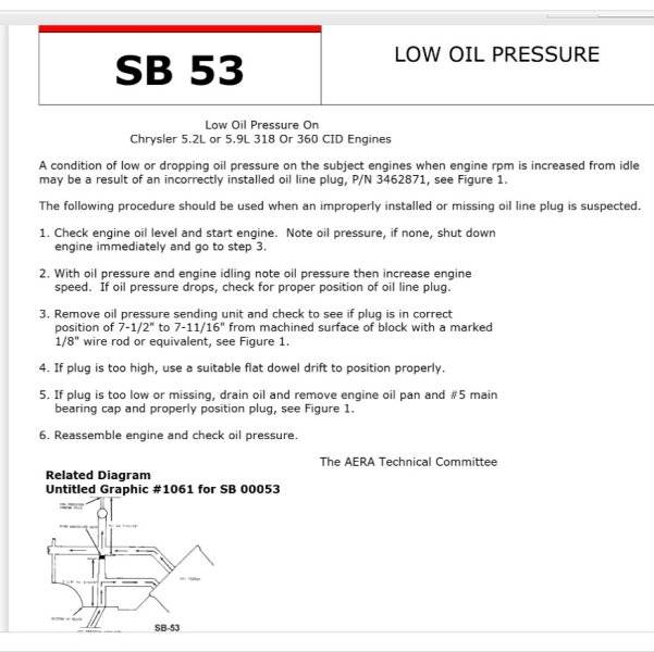

Try to find a well detailed manual for the small blocks. There are a few galley plugs lurking in areas that some don't know about. For thorough block cleaning, they need to be removed. And after it's cleaned you need to make sure they're replaced. Otherwise you'll end up with no oil pressure. Also on the tool list: tap and die set. Or at the minimum, taps in the sizes needed for all of the threaded holes. Either before its tanked, preferable, or for sure after its tanked, run taps through those holes and get the grundge knocked loose so you can blast it out at wash time.
There is just one, under the rear main cap (SBC also has one). It is usually a 9/16" freeze plug, measure it to be sure.
If memory serves me, near the distributor/pump drive bushing on the inside of the block, there is a threaded pug with a knock in galley plug behind it. There are a couple more? lurking in the block in other locations too. Specific sizes and at least one has to go in to a certain depth. Looks like your diagram illustrates at least one of the little rascals.
