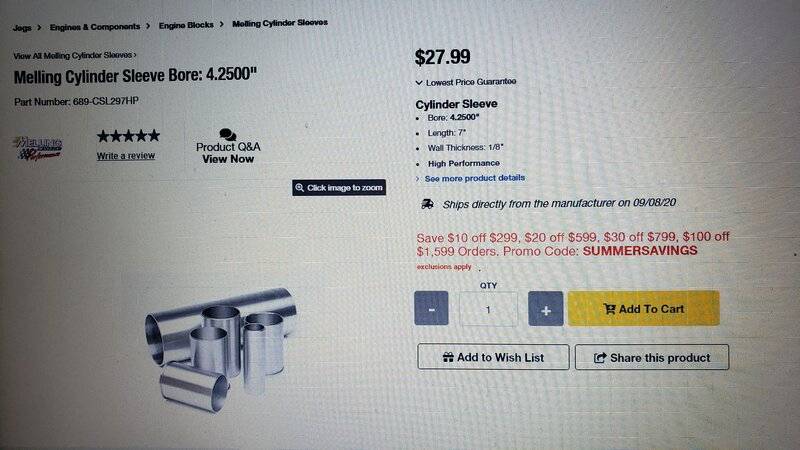

You can buy engine sleeves from L.A. Sleeve. I'd do my homework on what material to use. Sounds
like whoever you talked to doesn't know Jack!
Jeggs on-line.

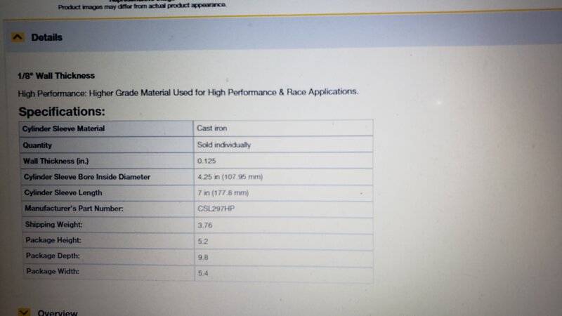

Yes my thoughts exactly I told them I would be supplying the sleeves. I know enough about them to think that ductile iron would be the best.
get watever LA sleeve recommends
ductile ost likely
