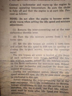

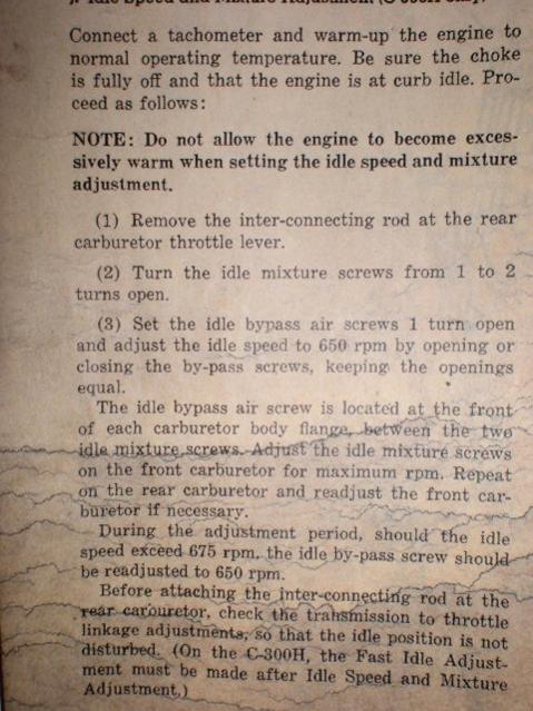

What you need,hope you can read it.

62MAX, thanks very much for the scan, that's exactly what I needed to see!!
Meep-Meep, thanks, shows you were on the money.
