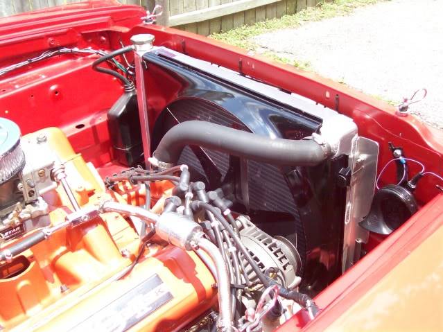

On my 63 Sport Fury I put an aftermarket Afco rad I bought from Mancini and I wanted to do the same thing as what you want to do. So I went to a junk yard and got a shroud from a V/6 Dakota truck. I modified it some and made it work. Its not perfect but it works good for me. Here is a pic of it when I was done. I also see some guys make their shrouds from aluminum and some of them really look nice. Ron

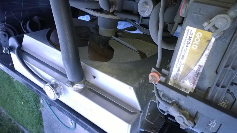

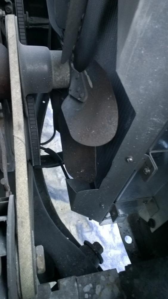

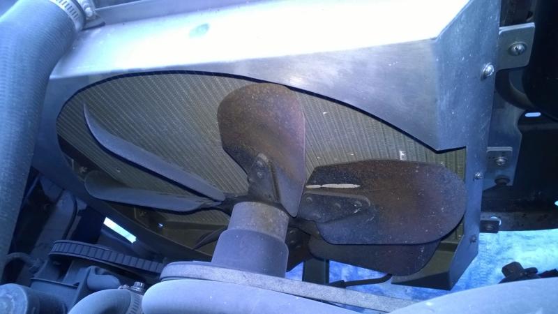

For what it's worth, this is what I did. Bought the universal shroud kit, made the brackets, and fitted the shroud. There is sticky back foam strip between the shroud and the radiator.
Joel
How did you guys mount the shroud? That's probably the biggest challenge.
I used the straps like the ones that come in a trans cooler kit. You know the ones that go through the rad core and take a plastic type of washer that grabs the strap and holds it there They worked good for me and are still holding up well. If you look in the upper left (drivers side) corner of my shroud you can see the backside of one as its about an inch in diameter. Ron
ron I like your old skool overflow catch bottle.
Yea I put that in kinda in a hurry when I put the eng in the car and just never got around to changing it. It actually works fine and the officials at the track have never said anything about it. Ron
