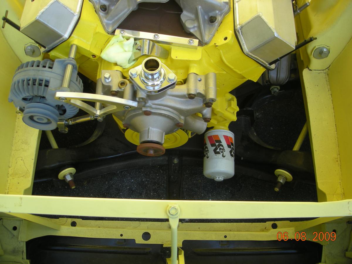

I have the same question. I am way over to the side...... And the tranny rests on the tunnel ???? Help ????
Here is mine.
I like that Alt bracket! Who makes it?
I got it from Summit racing... What headers are you using ?
