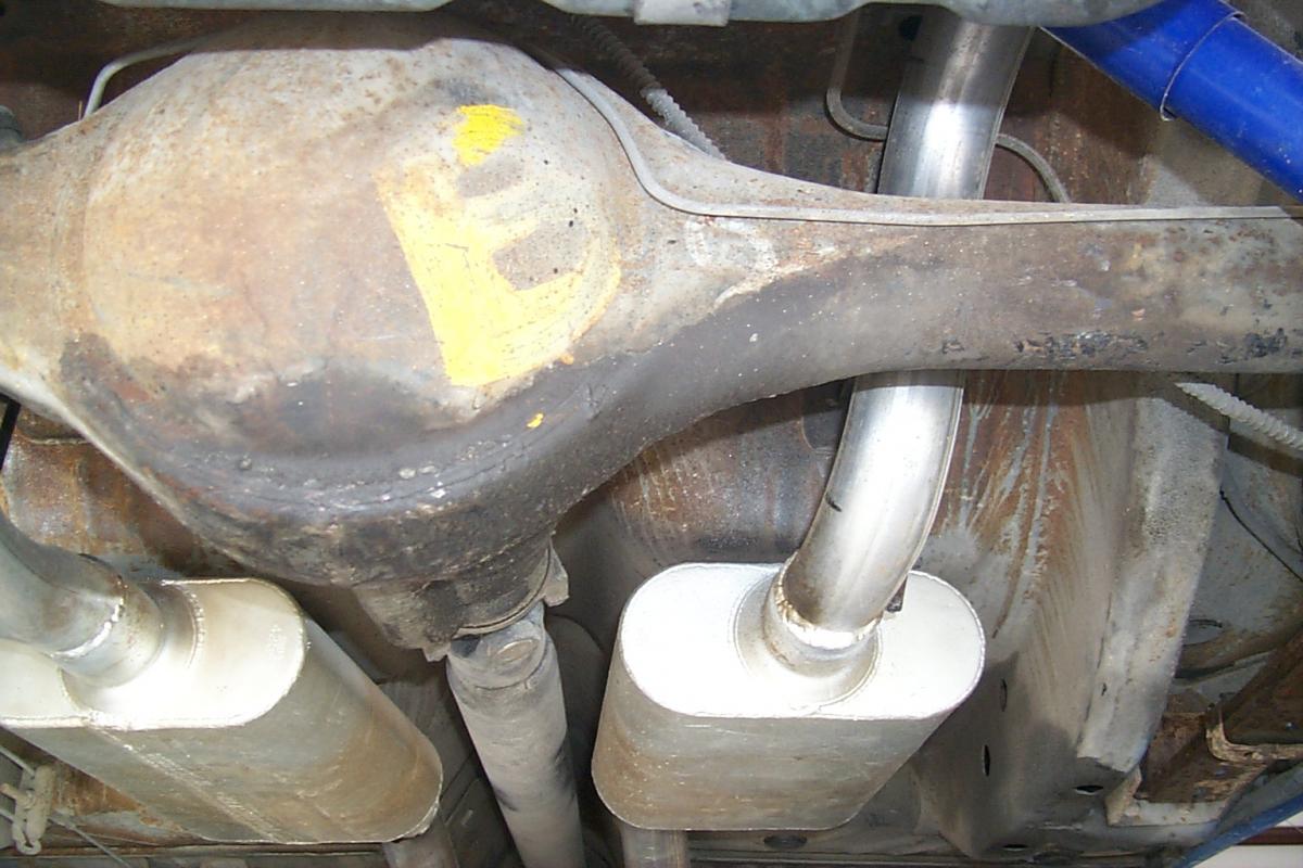

There will probably be paint daubs on practically every nut on the front suspension to show they were checked for tightness. I've seen orange, pink, and bright green paint used. I doubt the color mattered. On the 8.75 pumpkin there will be a mark on the plug and a stripe on the bottom under the pinion gear. I've seen a lot of white (or yellow) grease pencil marks on the back of the housing, making a circle with a B or an X inside. But that isn't always the way they were. (see pic below). This only scratches the surface.

wow thats quality control vs money control. 40 series flows are not oem though
