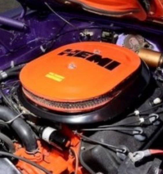

From the factory, did the 1970 Hemi engine, in the Coronet, have any decals?
Thanks for any info!!
I'm fairly certain 1970 and 71 Did.
1969 Did NOT
Well, the info I received from members of this forum seems to indicate that the early 1970 cars did NOT have any decals, while later 1970 lids did have the hemi decals. Here is what I found separately:
"426 Hemi" Air Cleaner Lid Decal Later-1970 through 1971 Plymouth, Dodge B-body, E-body. Not used on "Shaker" hood cars, but was used with performance hood cars. Early-1970 cars of any model did not use these.​
Photo inset shows an original decal on an original hemi engine
