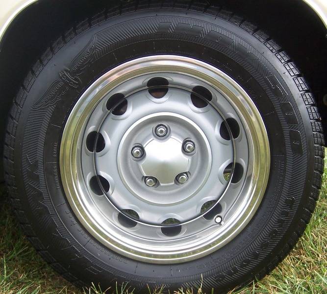

Is really HARD TO FIND trim rings for 8"s unless you make a custom set of rears with the same deep than 7"s in front and the added inch just on backspace. But the backspace limit to not disturb with springs is around 4.75" or so as far I recall depending on tires. There is a great thread about that applied to 3rd gen Chargers at dodgecharger.com who PaulG ( Member also here ) wrote up looong time ago. Sure Plymouths could be slightly diff due te wheel opening shape, but the same about inner side.

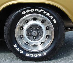

IMHO still with the right trim, 8" rallye wheels doesn't look right. The deal with the trim is virtually complete the half circle of the Rallye holes giving the full circle view, that is not completelly reached with 8"s still from the factory... of you care about that.
BTW rim size ( width and diameter, including offet measures ) is measured at the tires seat on rim, not at the outer lip
This is what I talk about the full circle view completed by the trim. This view is not reached with 8" wheels, still being factory
Althought there is a guy who told it fit 7"s trim ring on their 8"s wheels and this was the look he obtained.

But it must be something weird there. Maybe will change depending on manufacturer of the trim, as another member of Moparts also replies on here with a huge gap problem using 7" wheel trims on 8"s
