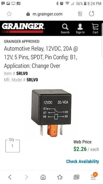

I had a spare relay, and just swapped it out. Many thanks for the advice @747mopar
The problem was the same with the new relay.
It is rated for 30/40 amps and did work with the old fan.

Does the relay plug into a terminal block? If so I'd still check to make sure none of the terminals pushed out. If no luck there check all connections then look for a damaged wire. I'm assuming your using the same ground when you bypass the relay? If so that eliminates the ground. Should be an easy fix, start at the fan (with the fan running through the relay) and test for voltage and work your way back to the battery, doing this will tell you where the bad connection is.
Just to verify the relay is wired correctly, 86 or 85 is grounded and the other connected to whatever your using to turn it on. 30 connected to 12V source and 87 to the fan (30 & 87 can be wired the opposite with 87 being the 12V source).
