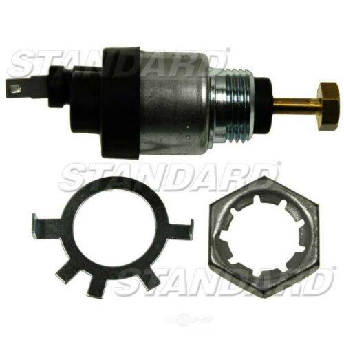

So I bought this solenoid from ebay for about $45.
It's advertised as a idle stop solenoid, but notice how it looks virtually identical to the solenoid in the Edelbrock photo.
My plan is to fabricate a bracket from a length of angle iron.
The challenge is the diameter of the hole.
I measured the threaded portion of the solenoid at 7/8".
I'm not sure I want to deal with trying to get the flat spot.
That seems like a LOT of work.
Hopefully tightening the nut will work.
I found a set of "Silver and Demming" large size drill bits on ebay.
Supposedly cobalt, but I have my doubts at $32 and free shipping for an index that starts at 9/16 and goes to 1".
However, even buying that, I'm still WAY under the $200 Edelbrock price, plus I now have a set of large drill bits.
So, after using the bits I will say that about every other one I used (progressively larger but skipping the 16th sizes) struggled.
3 of them cut a nice chip, and 3 of them needed fairly hard pressure and smoked a bit, requiring frequently backing off.
They did the job, though and I don't think I burnt any.
