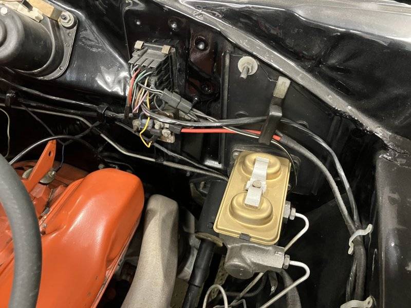

Lots of options. Several divots for such between master cylinder and bulkhead connector.

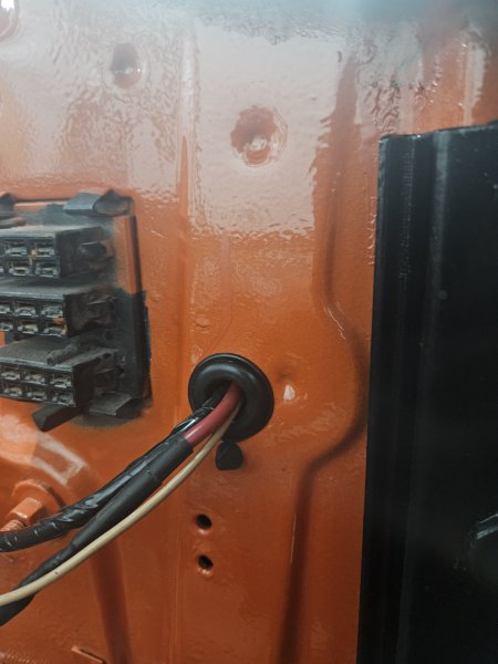

The divot you see to the right of the grommet is designed for the tach wire and 7/8 grommet on a 69 RR. Sadly the idiot before me that punched the hole in my firewall didn't pay attention to the proper way of doing things.
I’m a little anxious over making any holes in the firewall. 7/8ths grommet = drill 7/8ths hole? I can get any grommet at an Autozone, etc?

You can certainly drill a smaller hole, if you use this harness or parts of it your firewall will retain a factory appearance. Before I drill any hole I find a grommet and then drill. Drill at the dimple regardless of size, at least then its in the right place.

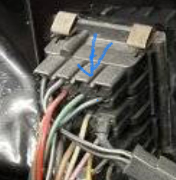

This part is the bulkhead connection. Pick an empty port and use it. Probably can run a small gauge wire all the way straight though if you want. Or get some male and female packard 56 connectors and do it halfway factory style. No drilling needed.
