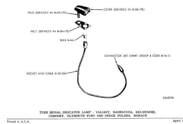

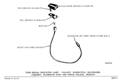

I'm gonna take an educated guess I'm not sure about your particular style but on a 67 you got to take the housing off and get it from the bottom I'm gonna say is only two Ways to do yours I got to see a picture of them but I'm going to say it's probably the same scenario
If it is as Tempest posted, you can see the stud with nut that needs to come off and lift up. That unscrews from the bottom to place bulb in the receptacle. Bulb is a 158.
