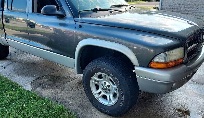

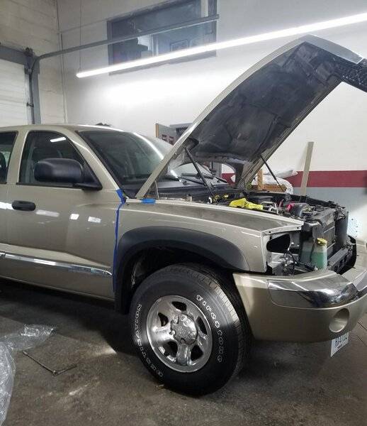

Asking if anyone has installed aftermarket fender flares on their pickups. Reason is its been a bust for me so far. After putting on new fenders, rust-free box, and new paint, decided to give the truck a different look with fender flares. Can't tell ya how long it took me to figure out the install instructions poorly converted from Chinese to English with b&w photos with better resolution I've seen in hundred year old pic's. So, finally got this figured out...then the flares won't sit flush to the body looking like crap! This was a no-drill kit hoping to avoid this. I've processed returning the kit. Photo shows the flare clamped in place looking at its fit before re-installing the inner well. Lol, looks fine here, nada with the actual put in. If anyone having done this has recommendations for a decent kit would appreciate hearing. Thanks

They look like the third generation flares so they should be correct. Here's the second generation flare for comparison...
These are installed from the factory with two sided tape and screws around the inside lip. Maybe check with the FTO truck forum or even a couple of the Dodge Truck forums I've seen on the www.
Your truck is looking good :thumbsup:

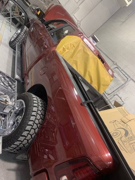

Okay. Ya once you get those centered. There a pressure fit. When the mounting hardware is put in place around on the wheel well lip the and the seal is in place. They should tuck up to the fender skin. Im doing a set right now.

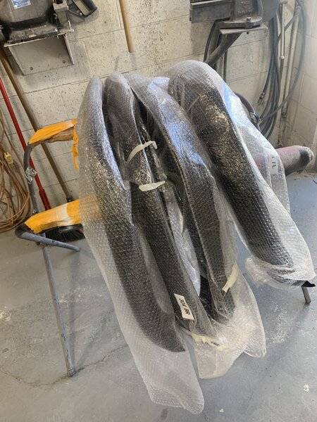

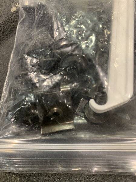

we get our kits from Raven truck acc in Calgary. But after market are just that. Fit them up prior to finish work. We do on average 8 or 9 pickups a year. What does the bag of goodies contain in your kit? Or do yours have preholes. ?
The white piece is for equal distance

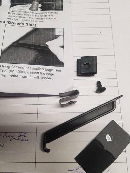

Here's the attachment clips, stubby screws, and adhesive tabs that go on fender lip where the S clips set. The instructions I got, crummy as they are, describe using the tool to install the edging to "more fit fender" and describing the 'flare' as the 'floor,' lol. Must be flares in China are called floors or vv. The flares have pre-drilled holes in them where you're to set the clips. What confused me for a while are these S clips. Only way these go on is flare sets over the bottom of them after inserting them over the fender lip creating a good 1/8" or more gap away from the fender. That's why eventually I wondered why these weren't just U clips. Who knows, I beat my head around on it long enough to return it and go hunting for a decent kit.
same items. You should try a factory set. The might be alot more money. But you dont have to drill out any extra holes.

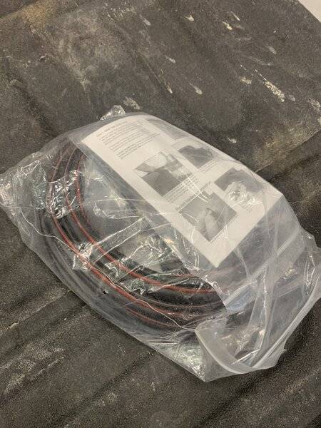

The picture you show is the same as what Im working with. The ones here will take about a hour to install. But before I commit to it. I make sure the body lines line up and wheel wells have no obstacles. .

Oh, my goof, looked like the clips in the bag in your photo looked different than what I have. Could be my IQ is showing despite 40 years of car projects; but this is my 1st take with fender flares. This kit from Auto Dynasty I bought thru Amazon was around $160 focusing on what looked good in the pics and no-drill thing. If a good kit is more pricy, I’m good with it to have it right. THANKS much for taking your time to chat on this! Greatly appreciate this.
