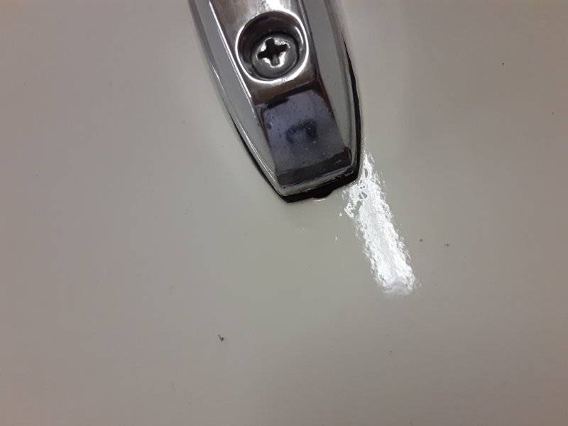

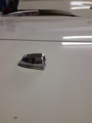

My 1972 Satellite came with factory fender mounted turn signals. The were pretty bad and do cost a little money. I had a set from a newer Plymouth, 73 and newer in super good shape but a different look. There were three holes on the 72 but the newer had 2 holes. I try things. Guess what? they worked with NO changing of the holes. The only difference is that the front hole can be seen a little. Second picture. I mounted the new ones and just had to put alittle clear silicone to fill the small half hole in front, See second picture. No one knows they do not look stock. So Cool. Original NO, but works great.

I must be no one cause they don't look stock to me.:D I never cared for the big 73-up lights. Dig the 71-2 Plymouth painted ones though. Have them on my 72 SSP.
Sorry, No one means those people that do not know about MOPARs. I like the stock too but did not have the money to buy another set, so i used these.
To the OP, I have a pair of 71-72 fender lights. They are chrome and have pepper pitting. Surface is still smooth. Wire connectors are in good shape. Good candidates to paint body color. $20.00 + shipping. Pics available if you're interested.
Agreed, the '73 & up fender lights are too clunky and not liking the exposed screw. But if I had a '73 I would have them on there because they belong there.
I have indicators(shells) with no lights. I'm debating whether to try to get some kind of led to put in them or find original light setup.
