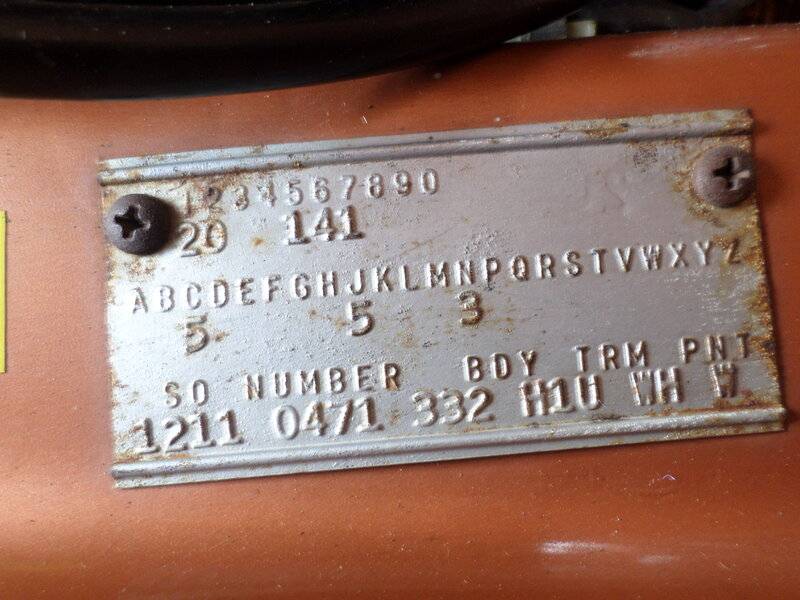

can someone tell me the original paint on my 1964 plymouth fury
Under PNT which is paint is the letter W which is the code for White....
From that I read the roof was painted white and the body was sandlewood. WH
The last W is upper door frame or molding insert color.
