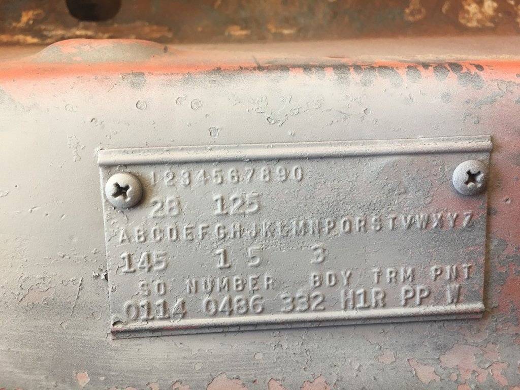

Anybody able to decode this for me? I find conflicting pages on what is what. Somewhere on here I read that AB of 14 is a Wedge car.... Does that mean that my car is a Wedge car?
Sorry.... Should have mentioned it's a 1964 Plymouth Fury
Ed, each different plant used a different setup on their fender tags but yours looks like a lynch road version. (4th digit of vin should be 1).
Getting to point, according to your fender tag your car came with the 365hp 426 street wedge (single 4bbl). Auto trans, economy am radio, heater with defrost, and I think the 3 under N is for backup lights (think).
Car was built on Jan 14th 1964.
Sounds like it was a cool car.
Leonard
It is indeed a Lynch Road VIN. Well I'll be darned... Thank you so much for your help Thunder. I hadn't planned on a big time resto with it, just a hot rod jobbie for my teenager's first ride... Know I might have to rethink that...
