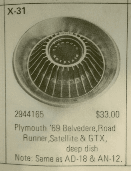

It could be for wheels. W15 was deep dish wheel covers.
