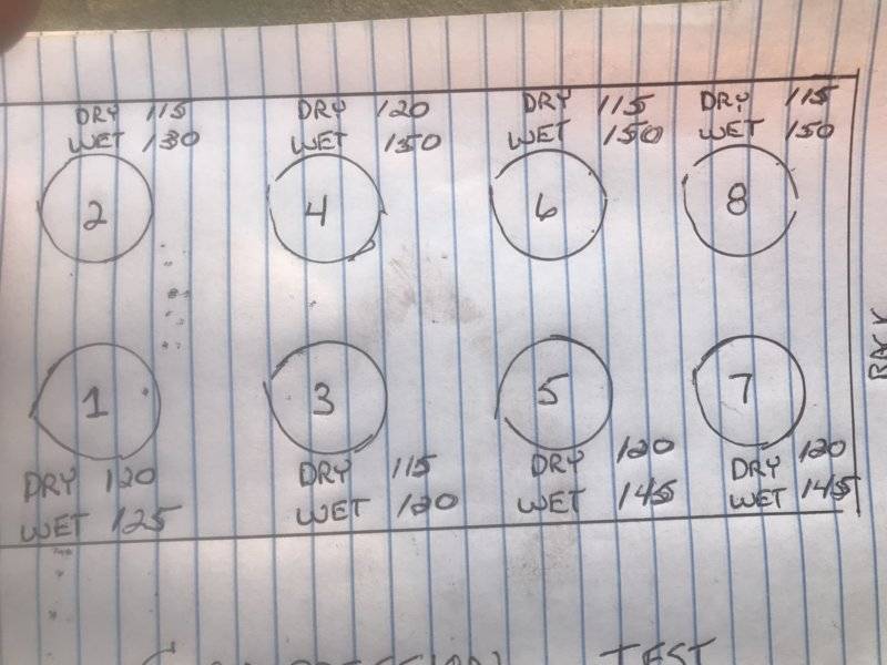

These are few questions directed to those that have maybe rebuilt or worked on more than one LA engine small block.
What is generally the largest difference you would want to see performing a dry vs. wet compression test ? I understand that it’s important that each cylinder be within 20 psi give or take. But what about dry vs. wet ?
I understand LA factory engines are pretty low compression engines. Having said that, what is a minimal psi a good condition La engine would be ? My understanding is any reading over 100 and all cylinders being within 20-25 psi of one another is important. A better question might be. What is compression psi on a freshly rebuilt La engine that hasn’t had the compression bumped up from stock ?
Lastly. Should an engine with a mildly larger cam have a little more compression than a stock cam. A slightly larger cam with stock heads, stock pistons.

72-360. First production year. Im not sure that year is a smog engine or not. Unknown cam. My over all compression is good I believe based on LA model with only a small cam modification. Everything else is stock related to compression. Stock matching numbers heads, etc. But, a couple cylinders might be showing slight wear due to dry vs. wet. I’m not sure how acceptable the differences are. But, overall no cylinder tested under 115 dry. My logic is, a lower compression ratio engine should have lower compression psi compared to an engine that has a higher compression ratio. But, that is theory.
one of these other guys is gonna know exactly what percentage is bad but i suspect those are nearing the edge.
cylinder 6 and 8 is the worst and also in line.
all the cylinders show various readings from loss of 5 -thru-35lbs of compression from wet to dry.
id say the motor is ready for a rering or rebuild or whatever you have planned.
just my opinion.
The only time I ever did a wet reading was to determine if a cylinder with a very low reading was the result of bad rings or a bad valve. If adding some oil brought the compression up, it was a bad ring. No change in compression was a bad valve.
Now doing a compression test, cold verses warm is what I'm used to doing. The thing is by time you get all of the plugs out, especially if you have headers, the block is cooling down. And by the time you get to the last cylinder it's cooler yet.
Your "dry" readings are really close to one another. I don't know how accurate taking a "wet" reading is between cylinders if they wouldn't get coated the same.
Are you having a power loss or blowing smoke? Are you doing the test with the throttle plate wide open?

No problems. Engine runs very well. Yes, throttle open during cranking. No blowing smoke etc. was just curious as to where the compression was. Yeah, I agree on the engine cooling down. It takes about an hour to do a dry and wet test. By that time, four remaining cylinders are completely cooled off by the time you get to them.

Dry readings all within 5 psi. Those readings wouldn't scare me at all. Run it.
Doug
145 psi factory so looking at tests u did it indicates a well worn engine.
as to your other question
larger cam with later intake closing usually results in lower compression
but with the factory cams and the long closing ramps
you can have a bigger cam that closes earlier
Well worn engines seldom wear to equal compression numbers. The number itself is subjective. Cranking speed, cam both are big contributors. Equal numbers mean its happy.
