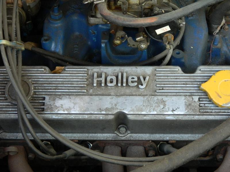

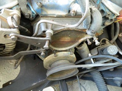

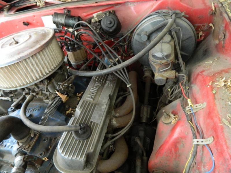

Would like to say hi to all, new to site but have a 72 charger to restore and plan on being here lots, so to start the car is a 72 charger with a 318 but looks like some work has been done to engine. I also found a water pump that had a crack and need to buy another one, so when I am looking for one it alway say with air, but this car is w/o air and will post pick of engine and any info on thoughts about it. So if anyone has a pert number of the water pump I should use please let me know. Thanks

Where in Alberta are you out of curiosity? I am an Albertan as well-live close to Drumheller. Only difference between A/C and non-A/C water pump is the fin count on the impeller-for your application you should be able to use either one. Seems to me the #s back in the day were WP975 for standard and WP976 for A/C, but that's from 25 years ago-imagine they've changed by now. But they are the same pump from (IIRC) '71 up to the Magnum era?
HTH
Jason
