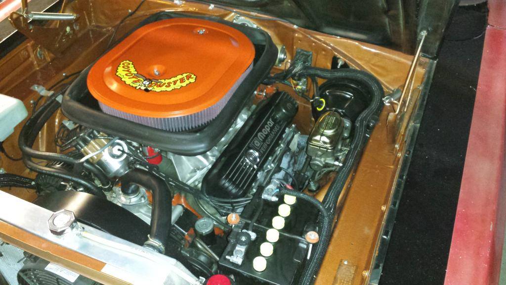

I have an aftermarket six pack hood and the stock hood springs are starting to crack and bow the hood from the high tension.
Does anyone know if aftermarket, low tension springs are made for a 69 B body? If not, would the 70 challenger AAR springs fit?
Not sure if you can see the springs in my pic here but I got mine from penstar reproductions east coast. Give them a call real nice peeps.
