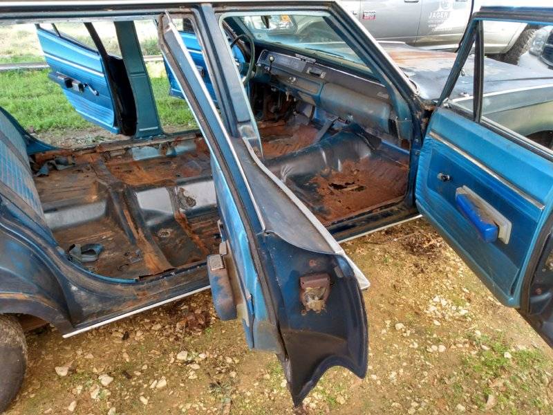

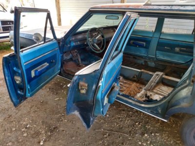

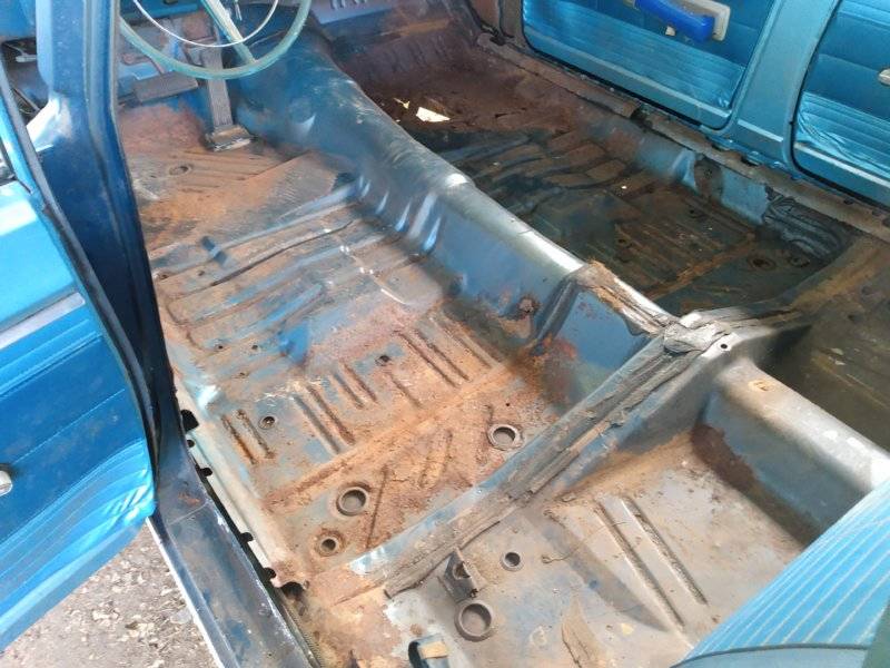

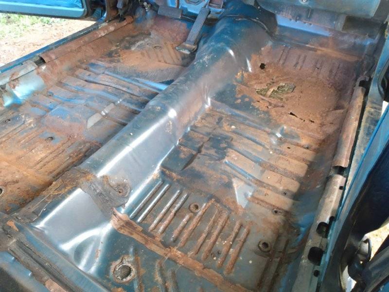

Well I got the interior mostly out and found a little more rust than I wanted. Time to start drilling some spot welds and get ready to order a new floor pan. At least I was able to get the passenger side doors to open and still working on getting the tailgate to open, really miss the days of living out west and having solid sheet metal to work with. Guess you can't win them all lol.
IMG_20200222_105435596_HDR.jpg IMG_20200222_105441776.jpg IMG_20200222_105411988_HDR.jpg IMG_20200222_105419187.jpg
How is the torsion bar crossmember? Good time to change it while you have the floor out.
Leaky wiper shaft seals -> wet carpet-> rotted floors.
Same old Mopar story.
Floor should be pretty easy in a wagon.
Looks like a great project.
