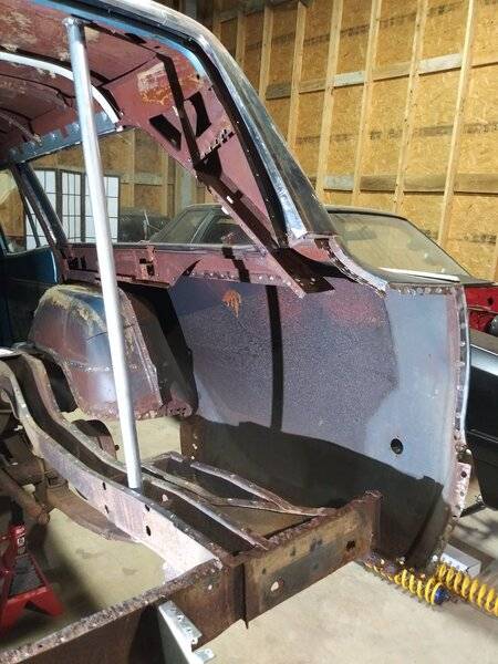

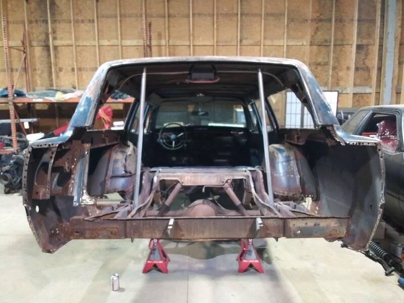

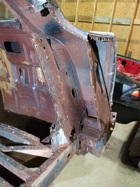

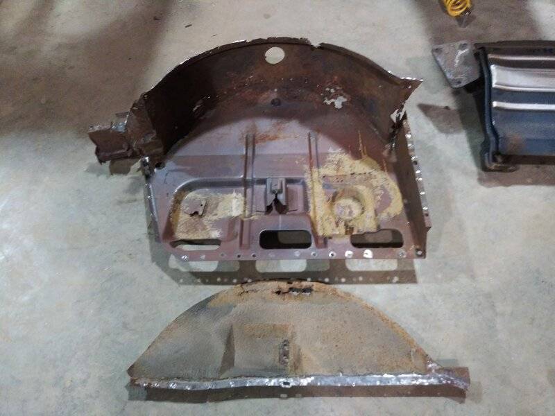

This past Sunday and tonight where good progress on the old 68 Satellite. Finally got the spare tire well drilled out and ready to make some support braces this week for the quarter panels so i can get the inner and outer wheel houses drilled out. When that is done its time to lay everything out and see what i need to order and what i need to fabricate. Then work on relocating the springs and mini tubs.
