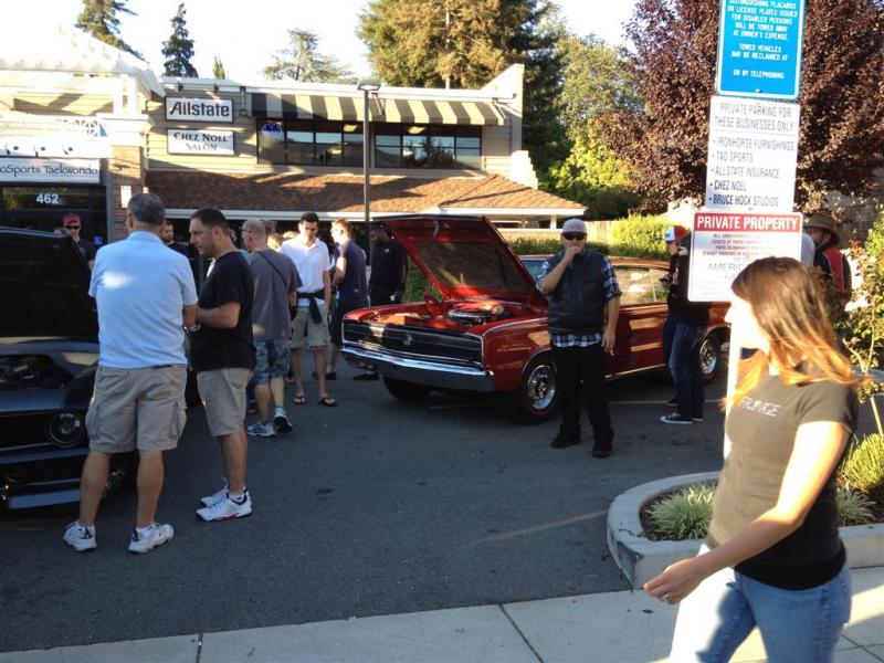

That includes tires and carbs! Yep, no more trailering it to shows because of expired out of state plates. We are legal and insured and I'm going to drive the wheels off it! I was hoping for a quick sale but most people looked at me like I was crazy for asking $65K for a super nice REAL hemi 4 spd car in a good color combo. So I decided to at least enjoy the car while I have it. I've taken it grocery shopping and other errands while I sort out the carbs and timing. Not the best pic but here it is at the annual Danville hot summer nights car show. This was last Thurs and it was the only hemi car there, and what's even better is I got invited to put it on display for my Haggerty agent. And he wants it back next month. My buddy and I have been spending a lot of time getting it dialed in for the next owner but it looks like until someone talks us out of it we'll be reaping the benefits of all that work. I'm sure we'll get over the trauma!

good for you meeps and you are right it does feel good.:headbang: couple of weeks ago i went to a cruise in my home town and was the only hemi---styling
I also got out for the 1st time this past weekend!It's a wonderfull feeling:headbang:
Hey Meeps, congrats! Hopefully it drives as good as it looks!
