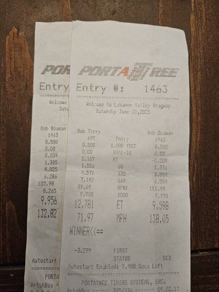

First pass was [email protected]

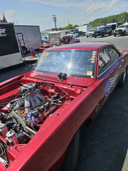

Sitting in the pits staring at the car during an extended oil down cleanup, I grabbed a buddy and had him push gas pedal to the floor.
Throttle blades were at about 3/4 open...
Past experience with my 440's had me believe there wasn't much gain by opening up fully for some reason.
But I spent time to get it as close as I could to fully open anyway. It's still not completely there but I'll work on that this week.
So I go up for my second timeshot and was i surprised...

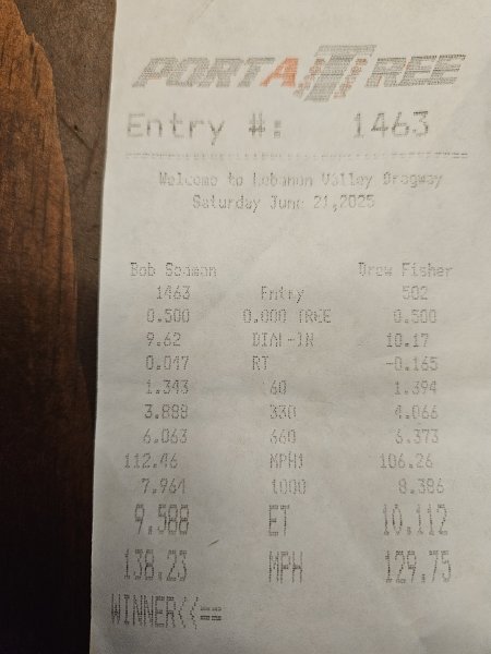

9.59@138! I still only have 22° of timing and it should take 25.
1st round my opponent went red so I ran it out and went 9.58@ 138.23.
Best part is I made it to the finals but lost.
Car was very consistent. First 3 passes @ 1/8 mile were all 6.06@112 and last 3 (round Robin so it was hot) were 6.08's@112.
