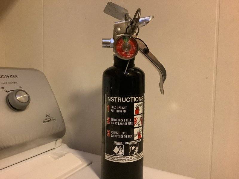

Not sure how old, maybe 5 years. The dial is flirting with recharge in the lower part of the green. Cost was pretty high IIRC. It’s probably low enough to be disqualified at the Texas Mile or Nevada whatever if I decide to pay 2 Grand or whatever the outrageous cost is for the privilege. This to see if the Hellcat really will go 202 mph as advertised.

HalGuard H3R. 2011. IIRC CoronetDarter and I each bought one at Spring Fling LA.
When you hit a car with dry chem you‘ll wish you paid for Halotron. I bought two a couple years ago, I don’t recall them being that expensive.
To answer the question, you don’t recharge the little guys. Recharging and hydro testing is for volume extinguisher business not 2.5lb portables. It’s usually an exchange as well, not literally refurbing the extinguisher you carry in.

Our guys sell the 2.5lb halotron for around $230 w/bracket. Halotron recharges run about $58/lb.

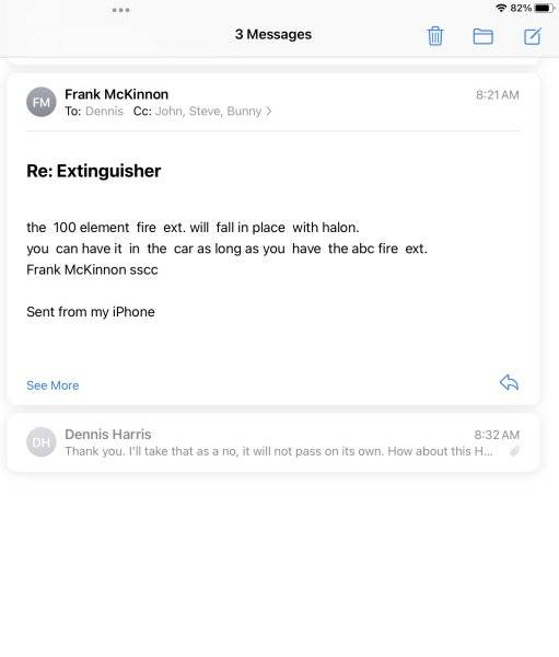

Sounds like it must be a conventional abc powder to pass. Wish it was more clear. I did clean up powder for 10 years after an engine fire in the Coronet. So, no Halon and no Element.
