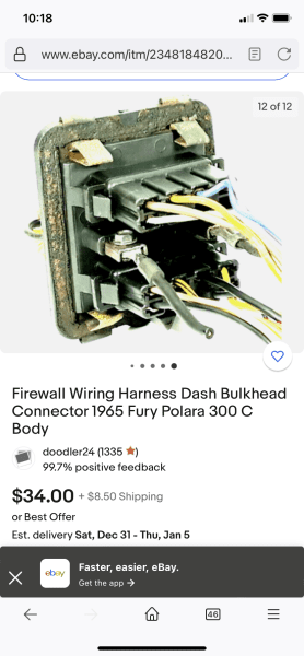

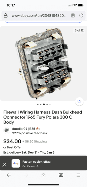

Dumb question…..don’t the older B-bodies have larger wires & connectors at the firewall? I think Big John over in c-bodies posted about this???

The difference on the early B bulkhead connectors is the power goes to a ring lug screwed to a solid terminal - not thru the typical male/female quick- connect terminals.

Are these c body connectors more heavy duty than the b?
