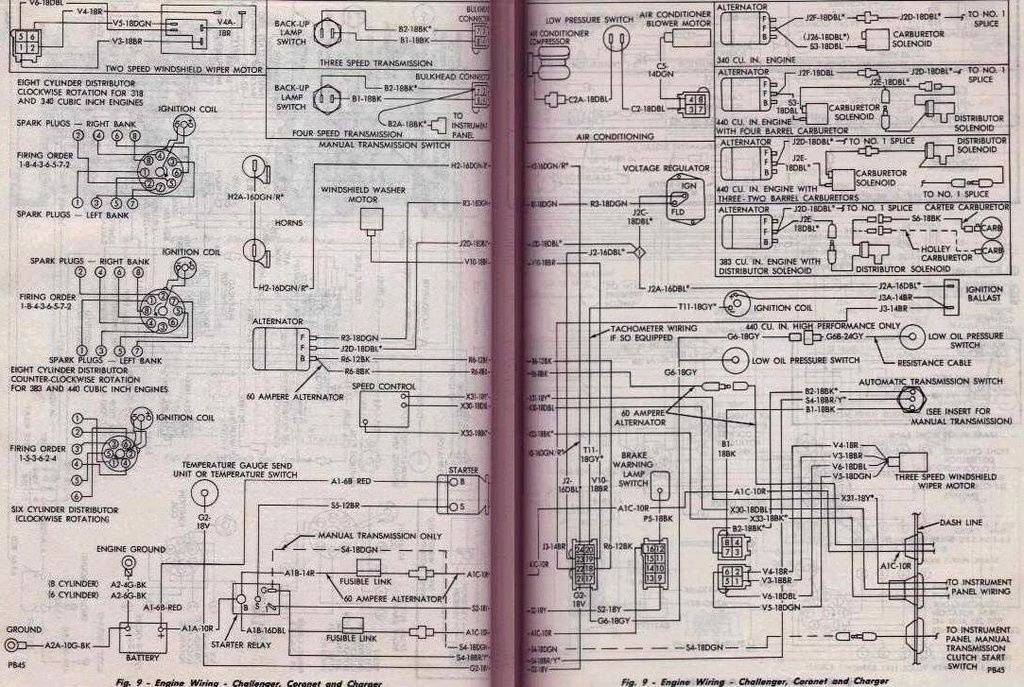

Dodge, but I guess Plymoutn should be pretty much the same. It seems should be spliced from inside the cab at bulkhead ( check the diagram insert )

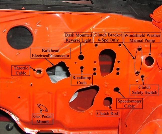

Most of the firewall layout in ’71 were the same as E-bodies, here is someone’s effort to document the hole locations on an E-body. There is normally dimples in all firewall locations where line workers added holes for various options.

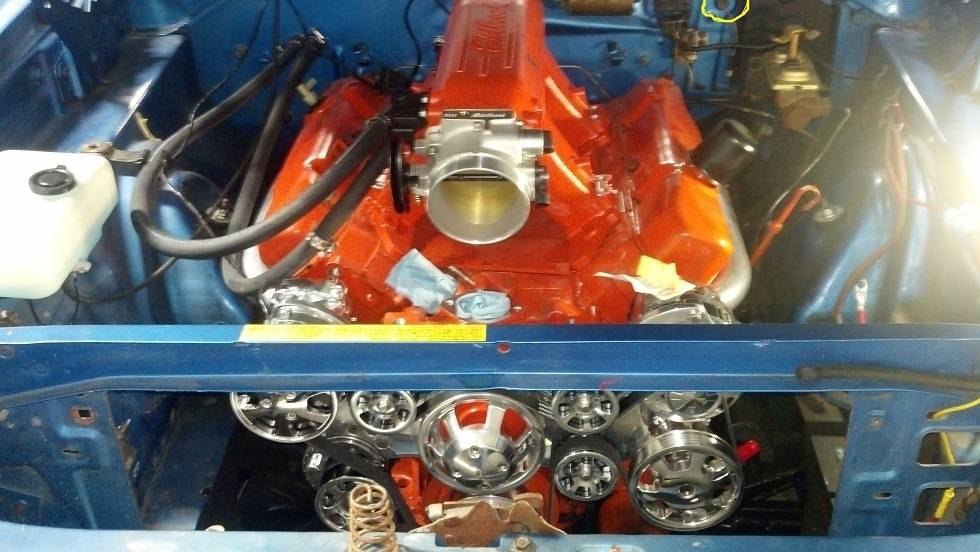

Not the best photo, I tried to circle what I think it is in yellow in the upper right of the photo. I was confusing the Tach and reverse light?
that could be the clutch NSS signal for the starter relay.

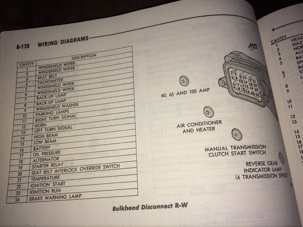

It’s well documented, at least in both ’71 &72 factory service manuals, that the 4-speed reverse indicator lead was grommeted through the firewall and connected to the transmission wiring on the engine side in those production years. I have never found any official factory diagrams showing exactly which dimples on the firewall were used for the specific grommeted pass-throughs. I know I’ve seen many examples years ago, fairly sure of the E-body diagram being correct for B-body for ’71 as well.
Thank You for your input.Makes sence it would be by the the bulkhead fitting since it plugs in to it by the wiper motor.
