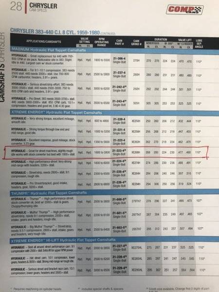

sonny what cam and grind did you use for motor? thanks
I used the same cam in my 383 and i liked it very much.
Can you share some specs with me? My timing is 18/36 and about 12-13 of vacuum with that cam. Sound like yours?
