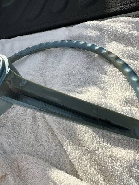

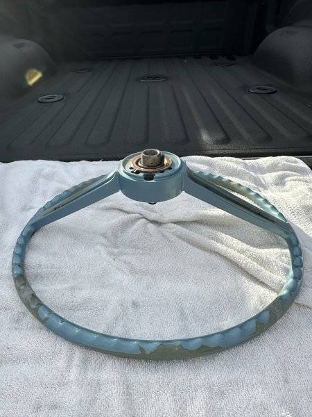

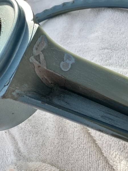

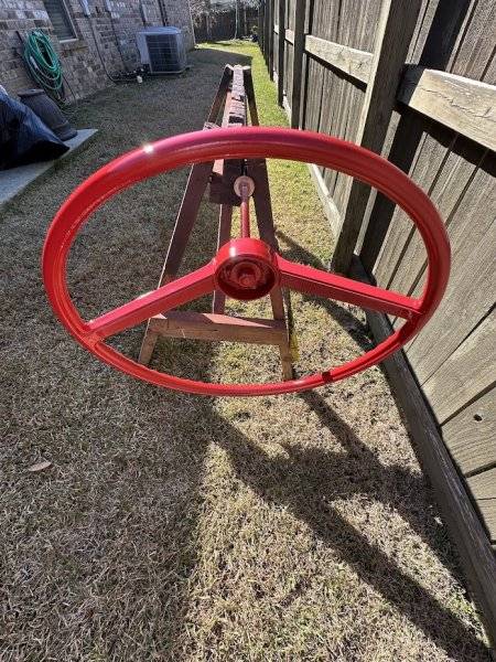

Taking my first stab at a complete steering wheel repair. I’ll post my progress!

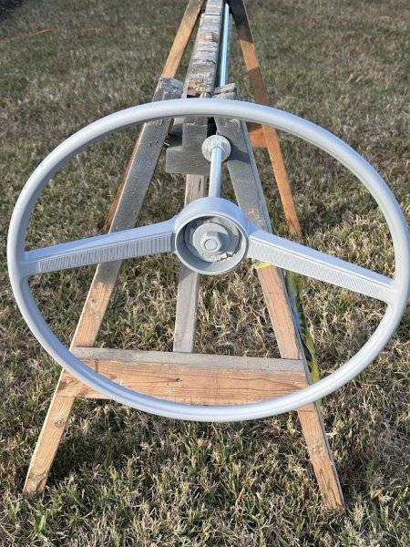

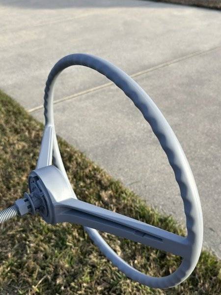

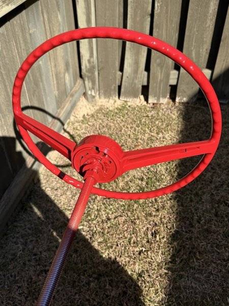

Hey guys, used JB weld original for filler after grinding out the cracks to a "V" shape. Then sanded it all down, cleaned it, wax and grease remover, plastic adhesion spray one coat, and then a few coats of 2k primer. Weather turned on me so stuck there for now. Next is wet sand 600 and then single stage PP1 Ruby Red. GTX your wheel looks great!
