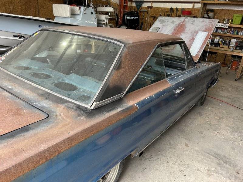

Hell Everyone,
I recently purchased a 1967 GTX with a 440 and 727. I am restoring in remembrance of my father. I am going to keep it as stock as possible but the only thing I want to change is disc brakes all around and maybe coil over suspension…I have two questions.
