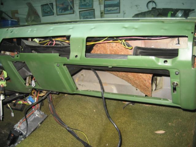

Where can I get a flat paint to touchup some of the scratches that is on the metal part of dash. I don't need to paint the whole thing. Just touchup a couple of areas. Color is dark green. Thanks in advance
This is color of dash
Might try a paint store and get them to match it.....
The trouble is that paint is textured. Matching the color is one thing, matching the texture is something else entirely. This is what was used originally.
Yes, lacquer is most likely what the factory used and it was textured (called a suede finish). I was unable to get the correct texture additive at my local auto body supply store so I just faked it by laying the last couple of coats on dry. It came out really good.
