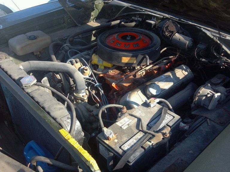

What is everyones thoughts? I replaced the rad, t-stat with a 165 one and unhooked heater core. Still runs hot....

do you have a shroud around your fan,can make a big airflow difference at idle.put up a pic if you can.
Step 2. Get something done with that funked up gnarley *** radiator. See that green stuff on the front of the core? It's toast. Only a matter of time before it springs multiple leaks in that area. It's rotten as hell. When the metal gets like that, it's ability to dissipate heat is severely affected.
I replaced the radiatior, thermostat and water pump, thanks. Oh, still hot on a hot day. Even has a 165 thermostat. Tried a 185 and 195 as well. The shrouds don`t appear to amout to much, but will try it....

Fan shrouds WORK as evidenced by their use in pretty much every car from the factory. If the manufacturers didn't think they needed them, they wouldn't be there. Proper use of a shroud and a fan that is placed correctly in it are primary concerns when trying to diagnose cooling problems. Almost every conceivable situation has been covered in this forum and a search will give you lots of info.
For the OP: What is the reason that your vacuum advance unit is plugged? Again, a search on this forum will give you some great info on reasons you should use it. Cooling is one of those........
I ordered a new Mopar performance electric ignition kit for it as the advance is shot. I did not know that would make it run hot. Thanks so much for that info. I have tried the search feature but don`t quite have it figured out yet.
