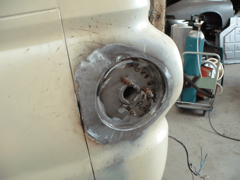

Some body mods may be required....
It doesn't necessarily just fall into place...
