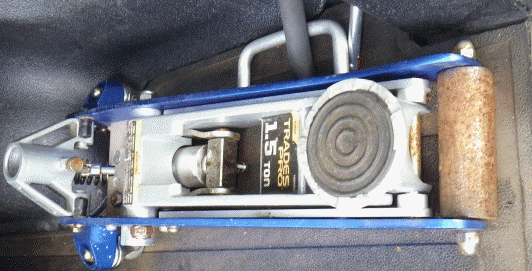

I did score a clearance 1.5 aluminum china special for 35 bucks some time ago. They had 3. I should have took them all for that price as this one has been better than expected. It's a decent lightweight jack to take with especially when trailering the boat around. I used it recently to lift my pool table onto and off my car skates recently when I put flooring down in the basement..
