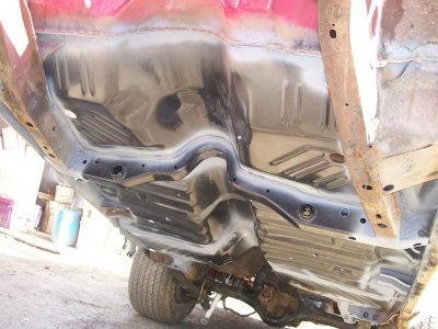

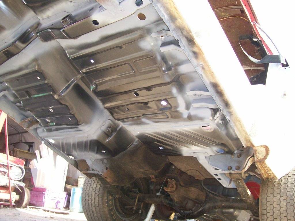

I did the one piece, the torsion bar crossmember, and the two rear pans in an E body. Took about 14 hours/$700. Not including parts or materials. Also did the left rear rail but that was not included in that time.
