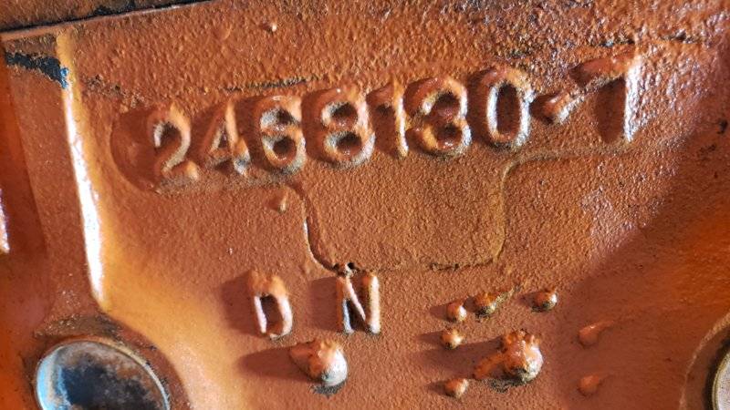

I have this 383 engine that was in my 70 Charger, will be putting it into my 66 Coronet at some point, just thought I'd see if this car is still out there somewhere. If you own this car and would be interested in getting the original engine back, let me know.

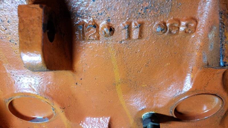

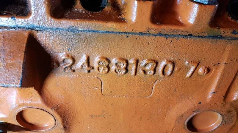

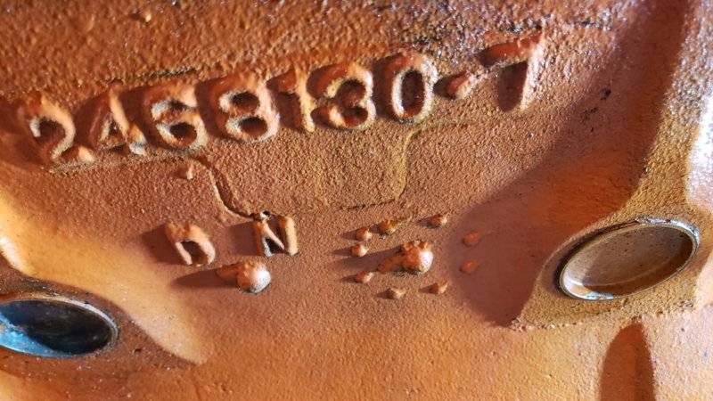

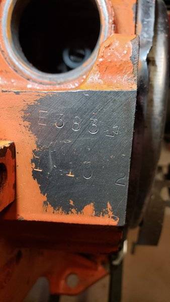

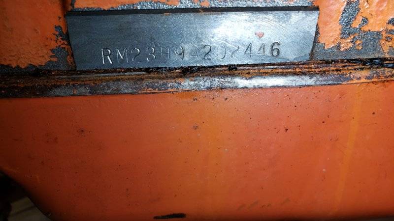

Any chance you can post some pictures of the EAD, cast date, and VIN? This is a new VIN to me.
D
As per the VIN posted that is out of a 1969 Road Runner.
Body Type: R = Road Runner
Price Class: M = Medium
Body Type: 23 = 2 Door Hardtop
Engine: H = 383 330HP OR 335HP 1-4BBL 8 CYL
Year: 9 = 1969
Sequence Number: 202446 = 102446th Vehical Built
Sorry for the delay...here's the pics of all the #'s I could find.
