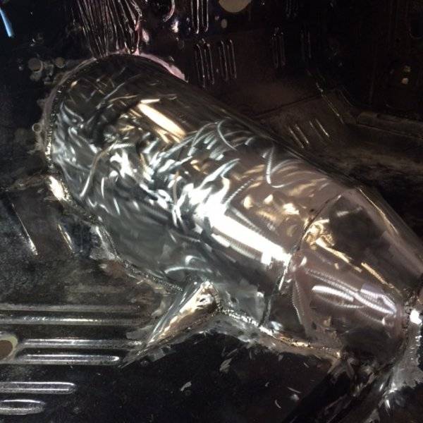

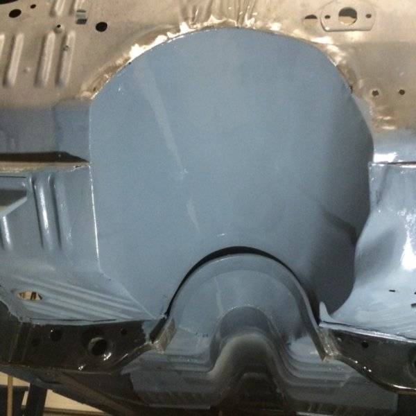

Mike67....The floor pan and hump DEFINATELY needs to be modified when you swap the GM for the Ried bell housing on the full swap from them! I am hoping all this extra work will be worth it when I finally get her on the road. I posted a pic of the modified hump I did to make it work...still have to wrap carpet around this TOO.
