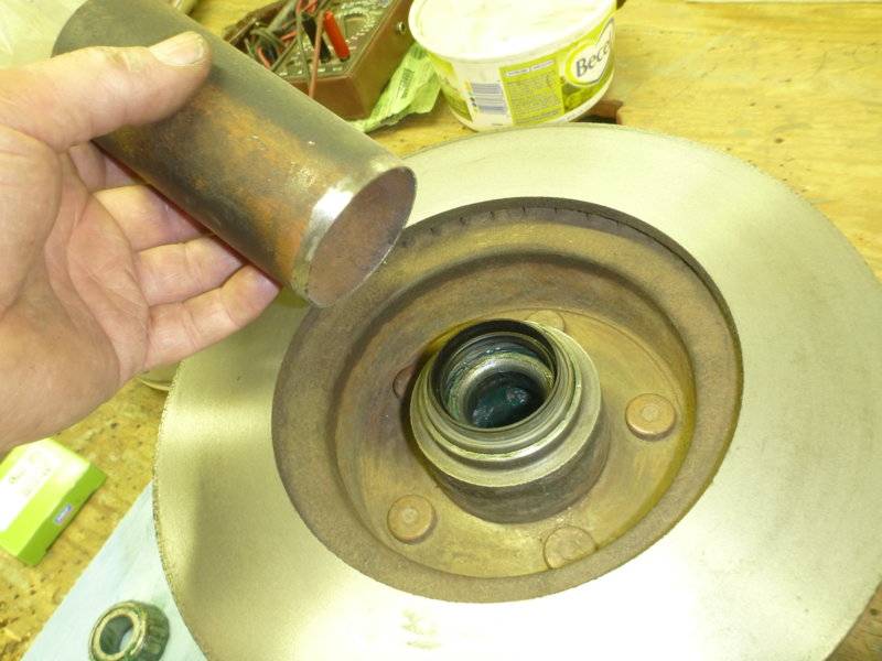

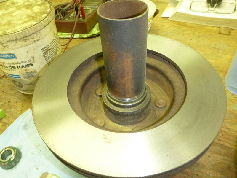

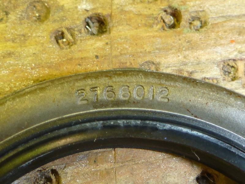

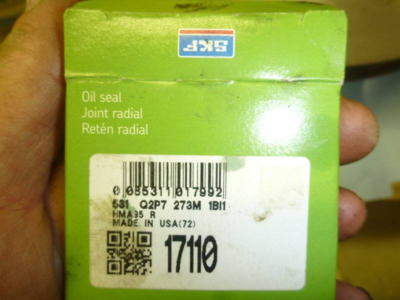

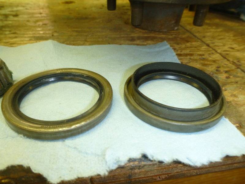

OE seal, at least on my Bird was part # 2768012. I ordered seals for a front disc '70 and received SKF # 17110 . They have an extended lip, like my '69 drum brake seals had, but worked just fine.

Yes, the problem is the extended lips... I'm unable to get it fit on the spindle. It's too tight
