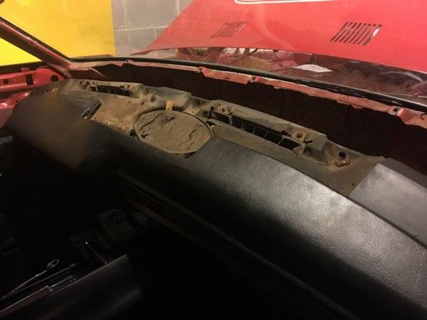

On a 73 Charger, does the front dash speaker come out from the top or bottom?
Thanks!

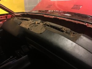

Top. You can see the speaker in this pic. The metal cover in the center of the dash has been removed.
3 phillips screws and 4 1/4" hex screws to the vents outlets and cover/grill will came out
then 2 1/4" screws to the speaker and done
