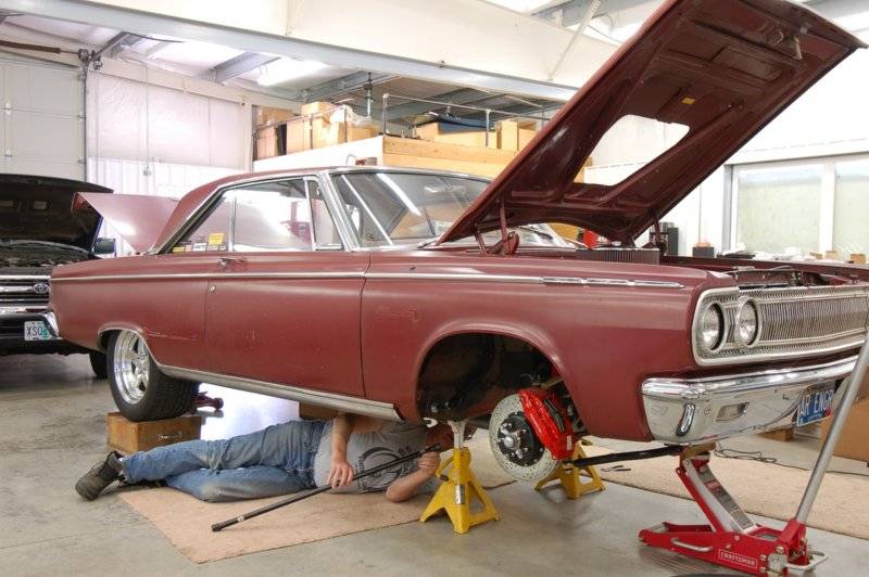

Depends on what car and which brakes. Some disc brakes can be set up to work either way but some can't. You didn't tell us what you're working on so it is hard to provide a good answer. I have the calipers on the front on my car but I'm using Porsche calipers on my '65 Coronet so that answer might not help you.

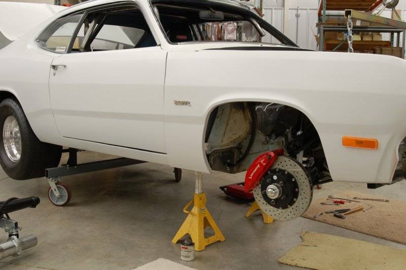

On my Duster I used Viper brakes and hung them to the rear. Most calipers are side specific so you have to hang them where they are designed to go. The most obvious clue is the bleeder location since it needs to be pointing up. If the caliper has staggered piston sizes then you have to mount them in the correct location or else the pads won't wear properly.

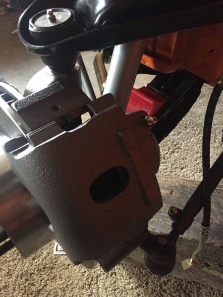

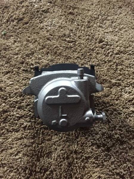

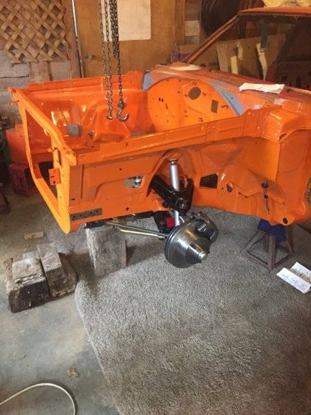

I found instructions on their website saying “most kits have the calipers hung rearward “. So I went to check the car today and that’s they way this kit is supposed to install. I took some pics. The caliper is marked L (drivers side) and that would put the bleeder screw up which is what we want. But as kern dog has mentioned, A bodies are front hung.
